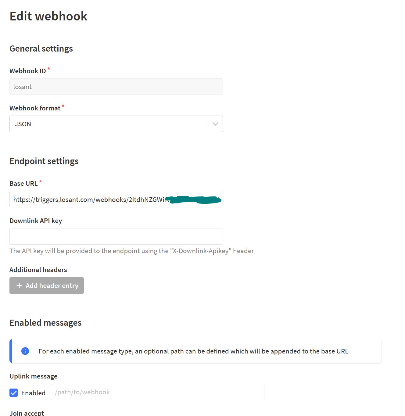

I am failing to configure a webhook on TTN v3 to push data to Losant, i.e. no data arrived yet at Losant.
Please see below my TTN v3 webhook configuration:
Any hint on a proper configuration is greatly appreciated.

Hello @Heath,
Thanks for your speedy reply!
I was actually trying that the first time, but the device status at Losant stays unknown and the data explorer shows no data as well. Maybe I am checking at Losant the wrong places to see if data arrived? Below a screenshot of my first webhook attempt:
