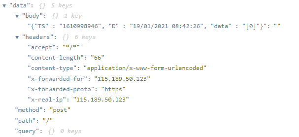

Further to my question above, I have two ways to send my data to Losant from my device.
1 - I can send the data based on time interval, which is not ideal for my application. I am receiving the data in Losant by using a webhook. Here is the payload result:
Note that I should have a JSON object in the body response, but that’s a secondary problem.

Hi @Jules_Huguenin,
I did some testing on my end and was able to reproduce the behavior you are seeing in the first image. When posting data to a Losant Webhook where the body of the request is a JSON object, the content-type should be application/json. When using content-type of application/x-www-form-urlencoded I experienced the same behavior you did:
When I sent the query parameters you mentioned in your first question I was able to successfully see the data in a payload in Losant, but in the query section, rather than the body section:
Let me know if changing the content-type to application/json works for you!
