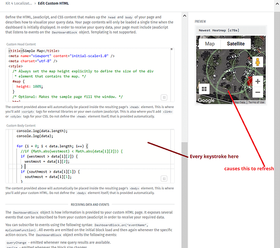

But I’d like to ask if there is a way to not have the page refresh and rerun the whole JS program every time a single keystroke is entered? Is this just the way JS works in browsers? Or can you add a toggle-button to the page which allows “Pause Javascript until my edits are done?”

For your other questions, if you edit the Custom HTML Block in fullscreen mode. The preview does not refresh. However, I can put in a ticket to see if there is a way to slow down the refresh while editing a block.

As for the preview mode, I’m still getting refreshes with every keystroke. It makes editing there impossible, compounded by since g*gle charges for every tile fetch

I just talked with the engineering team. We are going to improve this refresh rate.
For now, I can make two suggestions:
Experience Pages - Here, you’re displaying the map in a dashboard block. However, you can use HTML/CSS/JS to display maps in Experience Pages. The benefit here is that each map on the page doesn’t have to be within its own iframe.
Develop Locally - Depending on your level of HTML/CSS/JS, you can also create a local index.html and create your Google Maps locally. But, this brings up an obvious problem, you won’t have DashbaordBlock or the block’s data. For this, you’ll have to create sample data for local testing. When you’re ready to add to Losant, replace the references to your sample data with DashbaordBlock and set up your events.
I will certainly let you know if the team comes up with something else.
He can also open up a text editor (like Sublime Text) on the side and copy and do the code editing there and copy/paste back into the Custom Body Content once edits are done for validation and preview.
