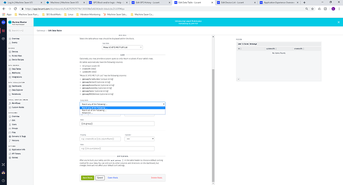

Thanks for your response, Julia.
It seems that the Device List Block, GPS History Block and the Data Table Block all use slightly different “filtering” methods… some uniformity in filtering capabilities might be helpful to your users.
Ex:
IMHO the most elegant solution seems to be the way that the Data Tables Block handles gathering the information with a “Query” to select the data which gives the user the most control over the data to display:
GPS History has “Block Data” for selecting devices:
and Device Block has “Filtering” for restricting devices:
Maybe I’m missing some design decision reasoning that make sense from the Losant developer’s perspective but I just thought I’d mention this to you.
