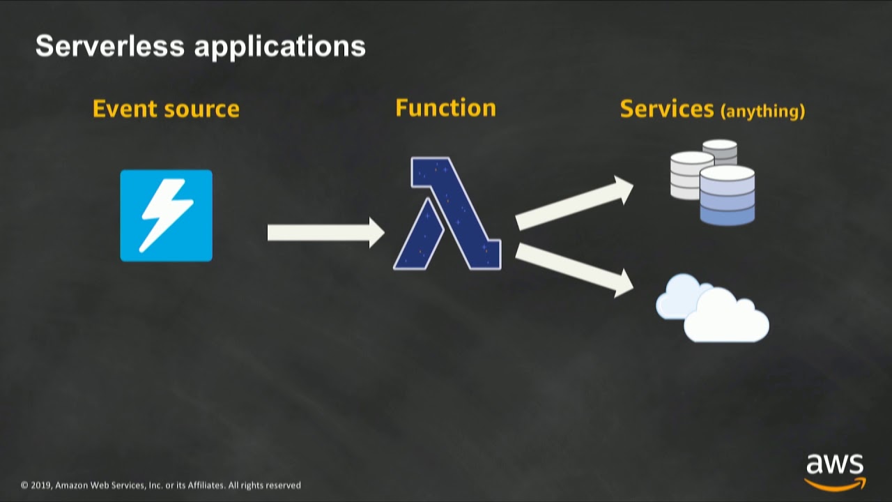

Here is a great video and resoruce online that helps pull some of these pieces together:
I recommend taking a deeper dive into AWS’s resources and going through some basic Lambda examples.
I’m recommending this route because of these questions:
The answers here depend on how you want to configure your Lambda function and application behavior.
However, after you digging to Lambda a bit, here is the answer to your questions:
The export doesn’t generate raw data. It generates a link to the raw data. You can make an HTTP request within the Lambda Function. And then, within the function, you’ll have access to the data, and you can decide where to forward it from there within your AWS environment.
