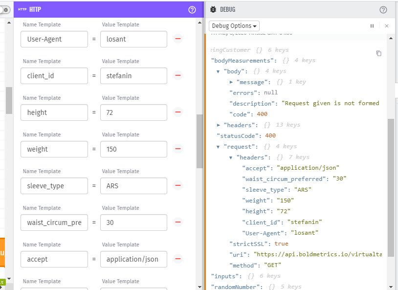

In my workflow, I am trying to do a GET request using HTTP node with inputs in the header and default SSL option. I am getting a 400 status code. Also why is strictSSL is showing “true”. Is this anything to do with the error? I think I have configured HTTP node to do the GET request is correct.
Hi Sreyams! You may only place headers there.
I think some of the information you have here should be provided in the query string.
https://example.com?weight=150&height=72

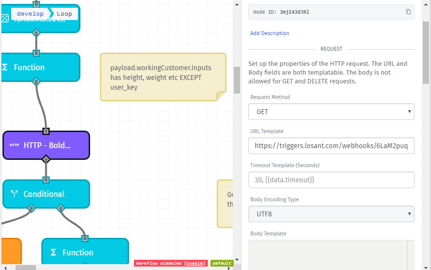

As you see, the function node has all the parameters
HTTP node is calling a webhook
In this webhook, I need to receive the input parameters and pass it to HTTP node URL that calls the actual GET. Here I want to give the user_key as well.

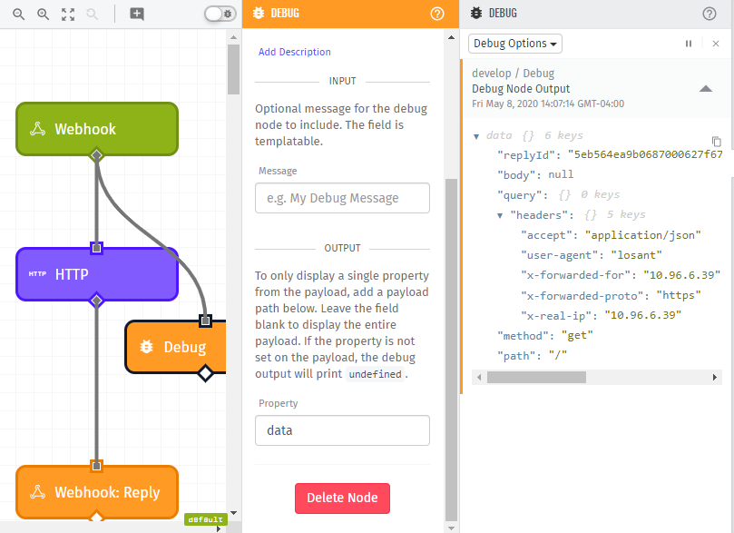

When your workflow with the Webhook is triggered, do you see the values of your input on the paylod?
You can see this by inspecting the Debug Panel. If you see your input values on in the Debug Panel can you provide a screenshot?
looks like data from the workflow is not getting into to the webhook … not sure if there is any configuration me not doing right

within postman it works. I think in the webhook, after the function that buids inputs like height, weight etc, I am assuming it gets passed to HTTP node that is making the call to a webhook. But in webhook, without even going to the extent of invoking another HTTP call, I am not seeing the input data not coming. Should’nt that come into webhook automatially?
correction … I think in the workflow, after the function …
Unfortunately, nothing happens automatically in the Workflow Engine. You have to pass data from node to node using the payload explicitly.
I recommend going through your workflow step by step, inspecting the payload. If data you expect is not there, you’re likely not passing values properly.
If you would like to trigger a Webhook from an HTTP Node, you will have to use query strings.
