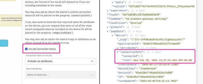

Using the Device: Get Node, you can select the “Include Connection Status” option. This returns the current connection status and the time it entered that status.
So if the device is currently connected, this will provide you the timestamp for when it connected.
If the device is disconnected and you want to know the last time it connected, I recommend using the “Get Log Entries” API endpoint:
This is the endpoint used to retrieve the connection log that appears in the Losant portal. This API endpoint will return all historical connect/disconnect events over a maximum time period of 6 months.
