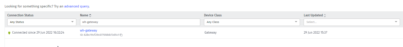

But then it never gets updated as disconnected in the device UI:
I refreshed the page a thousand times but it still shows connected.

Take a look at the timestamps in your application log message. Your “Connected Since” time is actually later than your “Disconnected At” time, and we are using the most recent value we have (including up to 24 hours in the future) for a set-via-REST connection status on the device object.
Now, any connection or disconnection requests that pass our validation should still appear in your live log and device connection log, and they would still trigger your workflows, but we use the value with the most recent timestamp as the source of truth when it comes to the device itself.

I peeked in your account trying to figure out what is going on here and I see that you are setting the connection status based on a call out to a third-party API. Not knowing what’s happening in that other service, all I can say is that it is possible that that could be the cause of the confusion, if they previously provided a connection timestamp and then provided a disconnection timestamp that predated the last connection. On the Losant side, we chose to go with the most recent timestamp (not the most recently received event) as what we would use to determine a device’s connection status.
