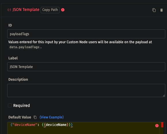

I’m trying to create a custom edge node to integrate with our remote logging solution. I’d like to include some details that are available as part of the default outer payload, like deviceName, agentVersion, applicationName, even specific deviceTags if possible. I understand that the outer payload isn’t accessible per the docs.
Obviously one could create inputs for each of these, but I don’t want users to have to specify what are essentially constant payload path references, and I haven’t found a way to default them to the correct path. The Payload Path input type does not allow for defaults, and the JSON Template doesn’t propagate templates as shown below (although there may be a different way to structure the JSON that does work).
In short, any guidance on an elegant solution for accessing payload paths from the outer workflow that are invariant to which workflow is running, w/o users having to fill in those parameters, would be excellent so we can get adequate context in our logging tool.

Something you could do to make this easier is make a single required payload path field and instruct users to enter “.” (a single period) for the value. This will pass the entire payload through to the edge custom node and you can pull the values from there. This assumes, however, that whatever workflow nodes run before the edge custom node aren’t doing things like moving, deleting, or modifying properties like deviceName.
Thanks a ton Dylan, this suggestion works well and is sufficient for our current needs, custom node is working spectacularly!
