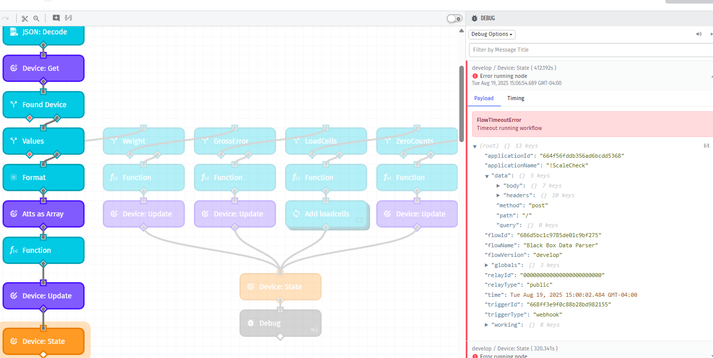

Im running into this issue where im trying to mass update a device attributes, to contain any new attributes they didnt already have that are coming in from this webhook, the update goes through successfully but then the state update fails and times out, the payload indicates that the attributes were added but checking the device shows it has none? im not sure if its possible another workflow to be overriding the attributes consistently in the time between the update and state update?
Can you drop a screenshot of the Timing tab? In most cases, it wasn’t this node that timed out, but rather this is where in the workflow it ran out of time. It would be good to what node used up the most time.

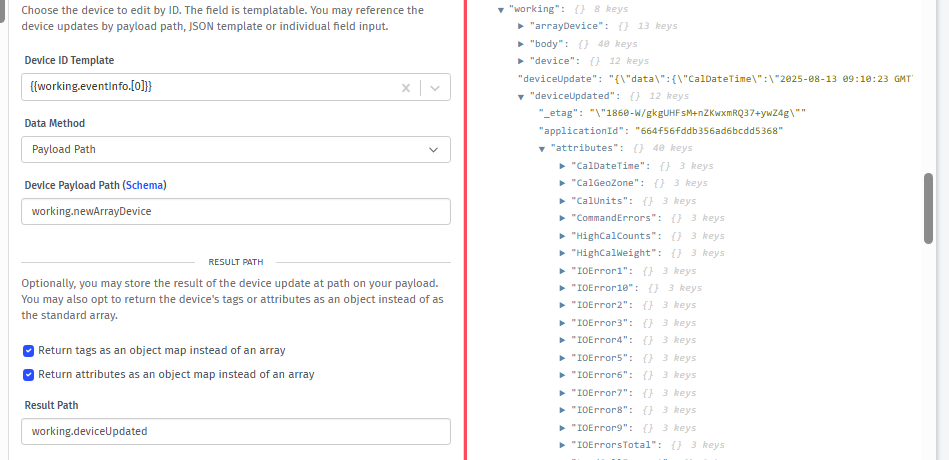

Yah the payload path for the device update node, suggest it succesfully added all the attributes, but going into the devices attributes page they are all gone
Im not sure why it would take so long to update, it only seems to be freezing out like this on this device i believe.
That is definitely unusual. We’ll see if we can reproduce the issue. Is it happening every time you attempt to execute this workflow?

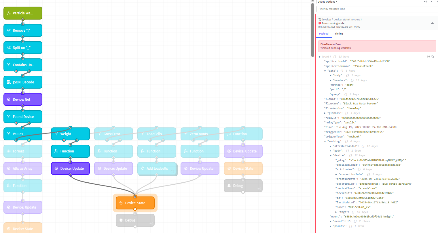

seems to be, only for this device only a couple of devices
here is a device working fine ^^^
here is another example of it taking a different path but the same thing happening, same device vvvvv

Somewhere in your workflows is a Device: Update Node, probably using the payload path option, that is not providing the entire set of attributes. Any attribute not provided with this option are deleted. Somewhere else those attributes are then recreated. We have not yet found where in the workflow(s) this is happening.

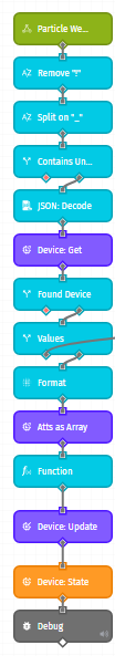

I have 3 of those device updates that i know of off the top of my head all in the Black Box Parser workflow
these 3 are using payload path to update device state, autoset thresholds and zero counts, are to change the attribute tags, and the webhook one is to dynamically add attributes since the names are unknown till they come in, is there a better way to do any of these. and or could they be causing issues

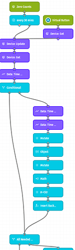

There are also potentially race conditions if you have two workflows executing in parallel attempting to update the same device. Both workflows may perform the Device: Get Node prior to either of them updating the device. This will cause the workflows to delete each other’s updates. It doesn’t look like this is a likely cause since I think everything is initially triggered from the webhook and subsequent updates are triggered by the resulting state reports from that.
There could possibly be a race condition as I have two different device state triggers both updating attributes via payload path, the concern here is that i dont see why the attributes from the webhook would be getting deleted as those should already be updated and assigned before the device state triggers go off, so if there was an issue with that i would only expect the attributes from the device state triggers to be having issues

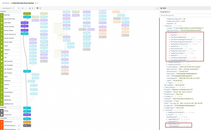

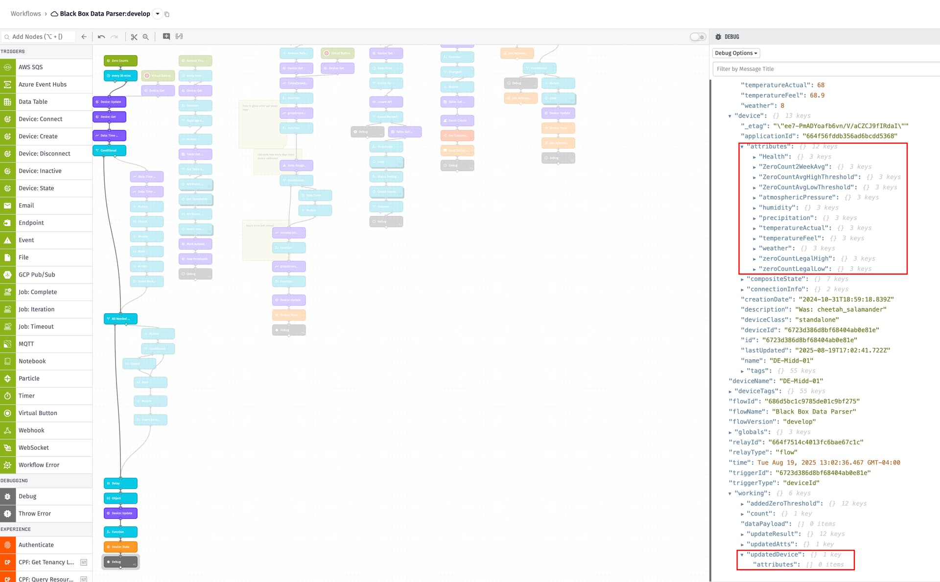

Here’s a run I found that removed all the device attributes. The original device coming in has 12 attributes, but an empty array is passed to the Device: Update Node. This would not be a race condition, this is an error in your logic that is not correctly keeping the original attributes on the device.
That said, the 2-second delay between Device: Get and Device: Update greatly increases your chances of a race condition. Even if that logic is fixed, if somewhere else adds another attribute during that 2-second window, the update will immediately remove it.
Yeah that would be it, probably assumed at the time an empty array would be ignored or something like that
