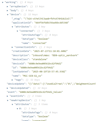

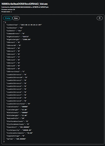

could it possibly be a race condition for these messages, i have them both coming up at around the same time. It seems that the device is only left with attributes from the second message
Potentially a race condition, but difficult to know. I recommend inspecting the debug output for wherever is setting that second set of attributes. You can mute all other debug nodes to reduce the output. Want to first rule out the logic before assuming a race condition.

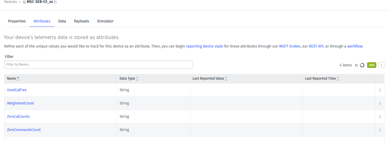

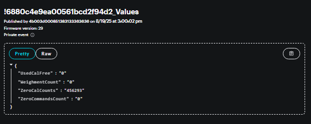

Maybe is a race condition, the second round of values coming in only shows the device having one attribute, not all of the others that were assigned in the first batch of new data
especially since the devices that didnt have their attriubtes wiped arent suffering from this issue, since they dont need to add new attributes they are preforming fine?
I doubt a race condition. Looks like the device only had the connected attribute before the update. As far as I can tell, that attribute is only set in the Check Connection workflow and does not use the Payload Path option. When you use Individual Fields, the update is atomic (no race condition). This means that device’s attributes were completely removed and then the Check Connection workflow ran at some point and added back the one attribute.
