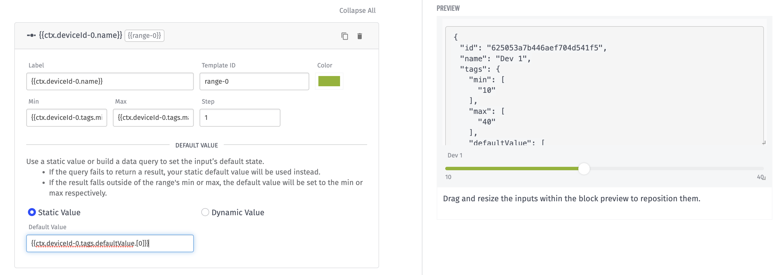

You already can use tags in input control blocks, provided you are utilizing dashboard context.
See the attached screenshot. This comes from a dashboard that utilizes a device ID context variable that also returns the full device object (illustrated by printing out the value in the help block). You can then reference the values of those tags in the input controls configuration, illustrated here by the min, max, and default values for the range slider component.
