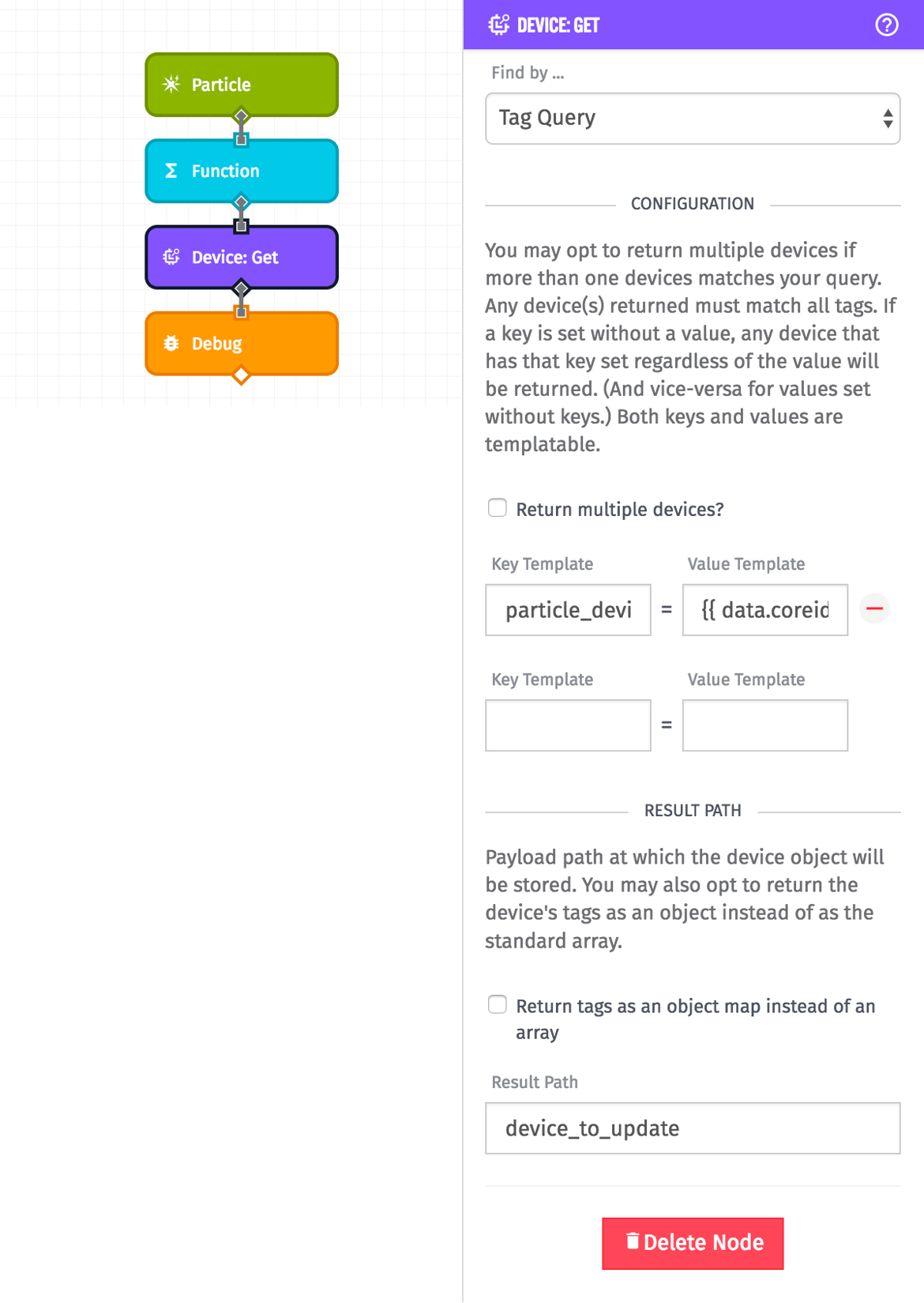

If you’re following the tutorial from the link you posted, then your “Device: Get” Node must not be returning a Losant device.
Can you paste screenshots of your Device: Get Node’s configuration as well as the tags you have applied to the device as you set it up in Losant?
It looks like your workflow screenshot didn’t come through; you do have the particle_device_id tag on your device, and it does match the value on your payload at data.coreid.
So in order to return that device in Losant, your Device: Get node should be configured exactly as it is in this screenshot from the article you mentioned in your original post. After that, you should have an object at the device_to_update payload path, off of which you can pull the Losant ID to use to update state in your workflow.
Let us know if you’re still having issues.
