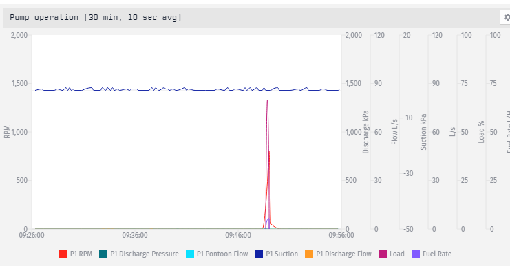

For instance we constantly change the period Time Series graphs and have to remember to chnage the header block to reflect the period.
Being able to include a template {{duration}} {{period}} would be really helpful in ensuring people understand what they are looking at.
Other templates such as the device in a gauge woud be good. I am alwyas putting the device name in the header block of gauges.
Here is an example of what we are always entering in the header
Thanks
Tim
