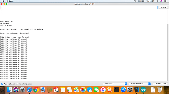

Hello, Julia. I also tried this step, and the error continues.
Hello,
I need some more information to assist with this. Could you provide a screenshot of your serial monitor? And, if possible, a picture of the board wiring?
Thanks!
Julia
I’m at my job now, so when I come back to my home, I’ll send these informations to you. Thank you, very much.
But considering that everything is right, what I believe you are, do you think it can be what? :thinking:

I uninstalled all the libraries and reinstalled again. I changed the value from 128 to 256 in the “MQTT_MAX_PACKET_SIZE” and it continues the same thing.
The error “Failed to read from DHT Sensor” is only in Losant code, because I already tested the sensor with an arduino example code and it worked normal, only with this code that gives this error. I used the exemple “DHTtest.ino” and it shows this:

Remember la pin number in you code it not the same than phisical pin. For example on the board say D2 but go like GPIO4!!! I adjut the image
