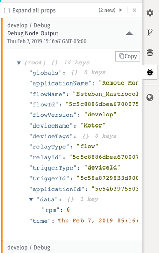

RelayType, which can be seen in the debug tab, is different based on where the Device State has been updated from. Data coming from a device will read “device,” and data coming from a Device State node will be labeled “flow.”
Here are the two debug logs, the first is from the device, and the second is from the Device State node.
11%20PM
Now, my dashboard will reflect the correct value of 6, showing that I have successfully updated the device state from the function node.
