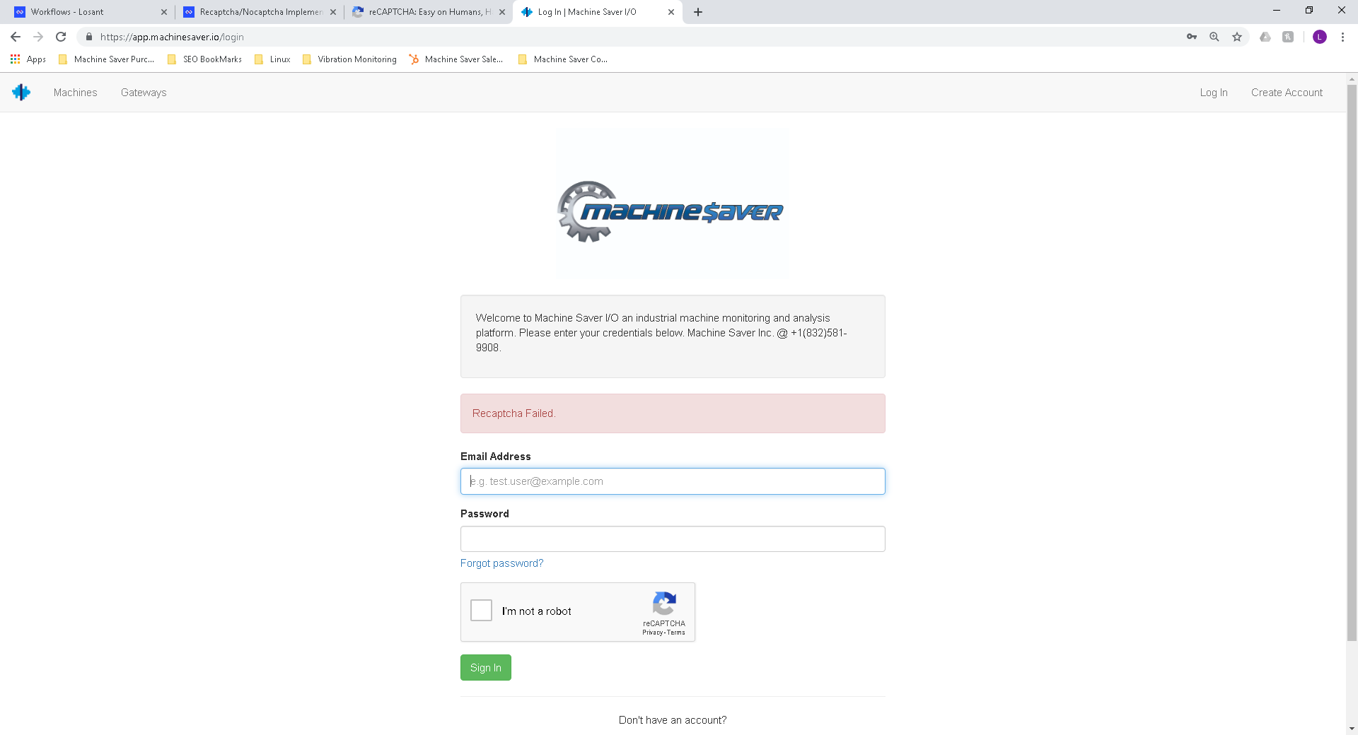

I’m sure its something simple I am missing but my recaptcha doesn’t show up until after I have submitted my form once. You wouldn’t happen to know a reason this doesn’t load until after the submission , would you?
Before Sign In Button:
After Sign In Attempt:
After this it seems to be working just fine.

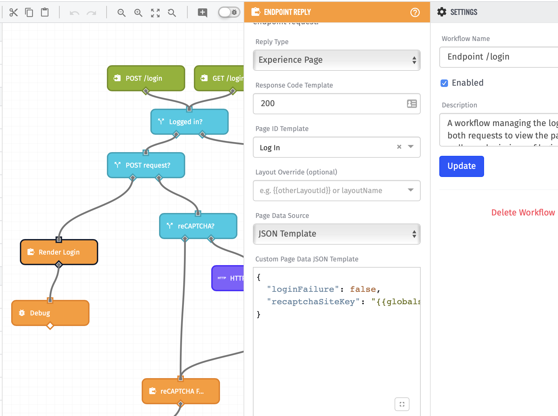

Hi Leo,
I took a look at your experience and was able to locate two possible issues. You seem to be missing your recaptchaSiteKey on the page render, which would cause the ReCaptcha to not display:
The second issue I found was in your ReCaptcha component. The bracket and parenthesis are switched, which is not valid Javascript. This may not be the cause of the ReCaptcha not loading, but could be causing problems elsewhere:
Let me know if this solves it!
Julia
Solved! It was that I wasn’t providing the recaptchaSiteKey to the endpoint reply node.
Thank you!
