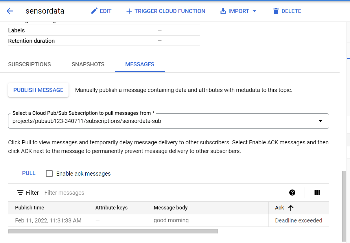

i have followed same thing what you said, but I haven’t received any data from GCP cloud after publish the data?
Hello @Nagarjuna_Reddy,
In the top right of your first screenshot, it looks like your integration is not connected, indicated by the red Plug with a slash through it.
Once your connection is established, your workflow should fire as intended.
Thank you,
Heath
In order for it to connect, make sure your topic name matches. You show your subscription, but you don’t show our GCP topic setting. The leaf name needs to be the same as you configure on the Losant side. We learned that recently ourselves.
Most likely the service account you set up in Google Cloud most likely does not have the necessary permissions applied to it to establish a connection to your PubSub service.
The blog post that @Heath suggested in an earlier reply also touches on this. I recommend checking that out if you have not done so already.
