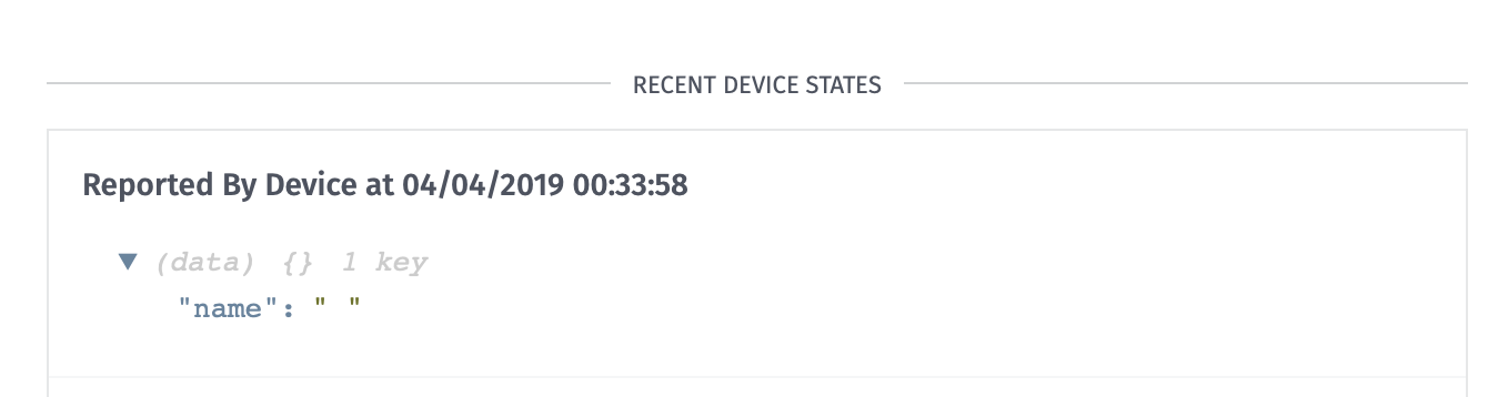

I was also unable to force a space character from the debug tab, but I was able to do so within a Workflow and from the Device Simulator. I simulated using the space character for one of my string values, and was able to get a state update with the “blank” string:
I also was able to report a space string with a workflow:
