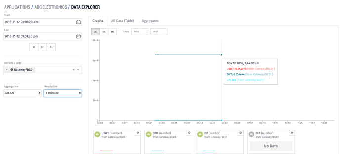

I am sending device state with a time. But I am not able to visualize this device state in any of dashboard blocks.
But I can see in communication logs that my mqtt publish packet is recieved and correct.
I have also attached a file. Please let me know if I am doing anything wrong.
Thanks
See attached. I logged into your account and am able to visualize the data point you reference in your screenshot if I use either the data explorer or the dashboard time picker to go back to the time when the state report occurred. (Note you and I are in different time zones, hence the hour discrepency.)
Dashboard blocks continually update to only show data for the last x minutes / hours / days worth of content, so in your case, once 60 minutes passes from your last state report, you would no longer see that data in the time series graph and the data table.
Please let me know if I understood the problem correctly and if there’s anything else I can do to clarify the dashboard block functionality.
