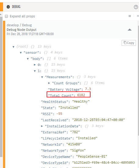

Under State, Attribute, how do I enter an attribute that consist of 2 words (separated by space)?
You need to put the key in brackets. So it would be -
{{sensor.body.1.Measurements.[Total Count]}}

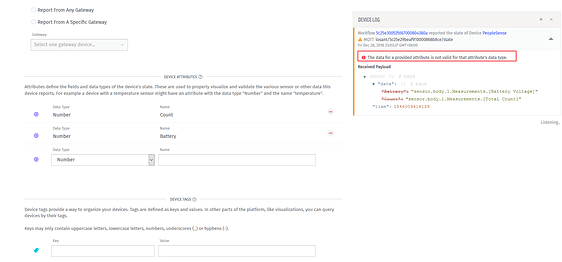

Dylan,
I made the changes you suggested.
I got this error:
