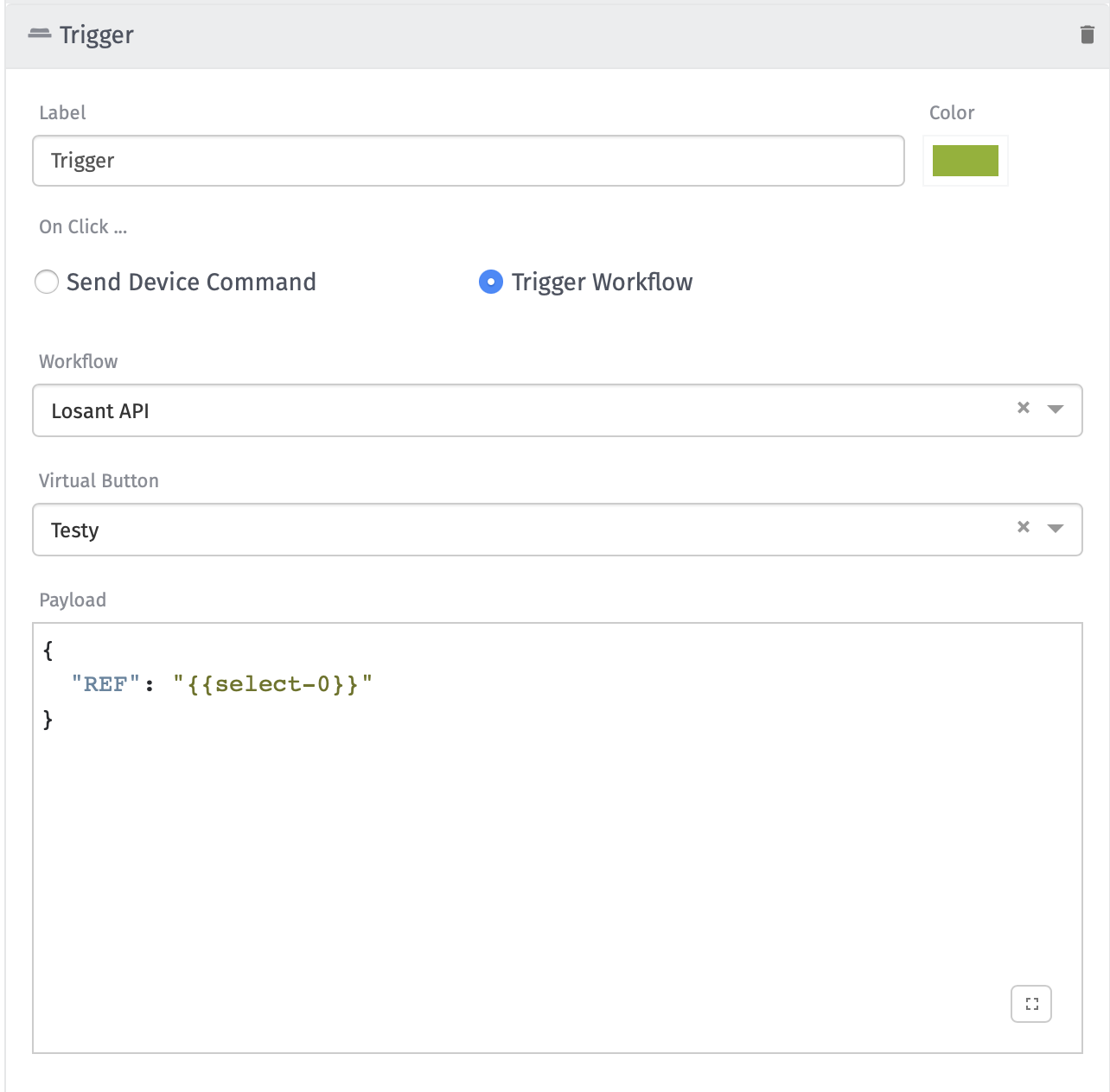

The second change you will need to make is in your REF workflow with the Particle Call. The configuration as it stands currently is sending only “REF” through the function. I believe you are trying to send the label value that was selected on the dashboard, such as “RF2” and “RF3,” but the only thing being sent is “REF,” so you may be printing that you have no data as “REF” is not a conditional in your Particle function.
Applied Changes Examples
You are currently getting two values from your dashboard, “REF” and the value selected by the dashboard user. These are some changes I would recommend to make this easier on yourself!
The first is to remove “value” and replace “label” with “REF”, so your payload will look like this with only one value:
The second change is in the Particle Call configuration:
These steps should clear up some confusion and hopefully fix your Particle node!
