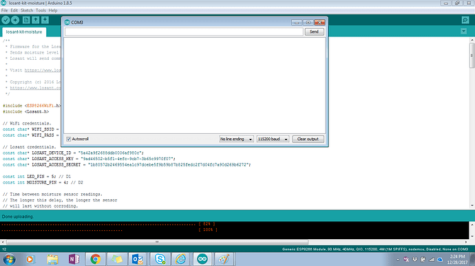

We created the moisture sensor kit and followed instructions. The firmware did download on the sensor but we do not see anything on the serial monitor
The first thing to check is that the baud rate on the serial monitor is set to 115200.
Yes, It is. What else can we check?

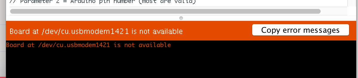

You can also try closing and re-opening the Serial Monitor. When you do attempt to open it, are you seeing any error messages in the Arduino IDE’s output? Something like the following?
This is what we see
It is strange that it flashes successfully, but then nothing shows up in the serial monitor. Please try pressing the small “RST” button on the NodeMCU while the serial monitor is open. That will reset the board.

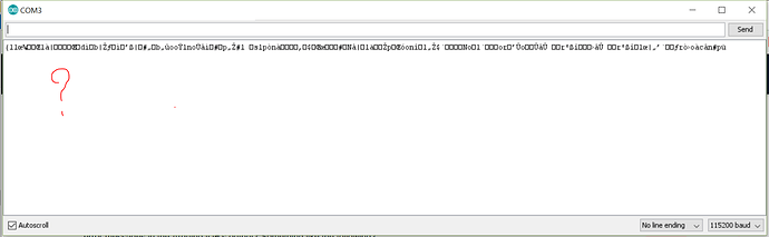

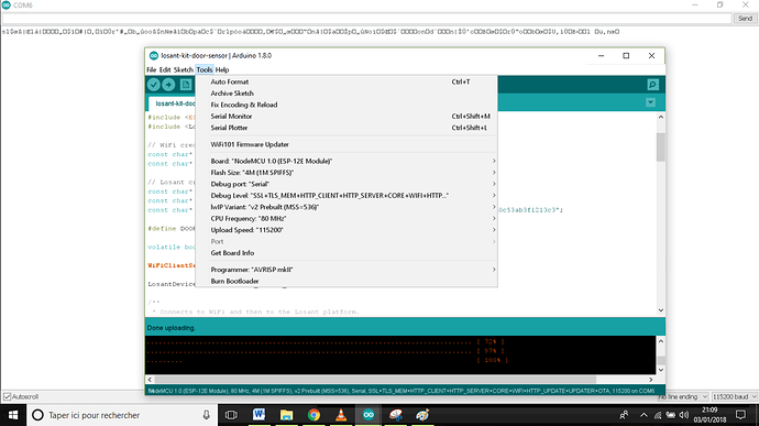

I have this display problem so i followed the steps in this discussion but i still have this issue. At the beggining, I used the latest version of Arduino IDE, due to these errors I installed Arduino IDE 1.8.0. Now I can see the first message on the monitor but there are no other messages (connected, open door, close door)
I use the door sensor kit (following the tutorial)

I see the same first line after pressing the reset button
The first line of unreadable characters is expected. Those are printed by the ESP as part of the boot process. It should then immediately start printing other stuff. I’ll provide a simpler firmware shortly just to test that the boards are working at all.

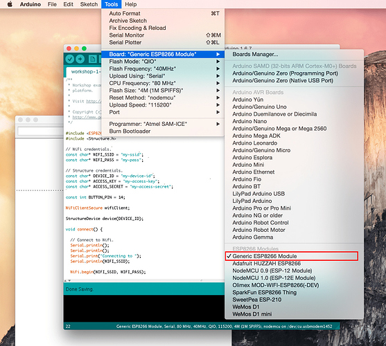

Another think to double check is that the “Flash Mode” is set to “QIO” and not “DIO”.
I used the basic sketch with Generic ESP8266 module (2.3.0 and 2.4.0) but I have the same issue. I can’t get any serial communication at all (after the first line).
I pressed the small “RST” button many times. It duplicates the first line (no Hello word).

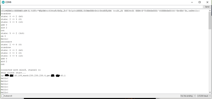

For the good news, I started with the basic application ‘Hello’ and it works properly. After that, I used the same configuration for the door sensor kit and I succeeded to receive data on my DASHBOARDS losant (I tried also alert email and it works properly)
For the bad news is that the serial monitor does not work on the application of the door sensor kit despite that I manage to receive the data on the cloud.
