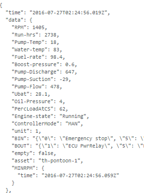

And payload
However if I select specific device/tag I do get a MIN value set in the payload.
To me it seems the device id in payload doesn’t work as I expect.

In case I didn’t userstand the “Device ID(s) JSON Path” I have tried
deviceName
data.asset
payload.deviceName
payload.data.asset
And none of these options had any effect.
