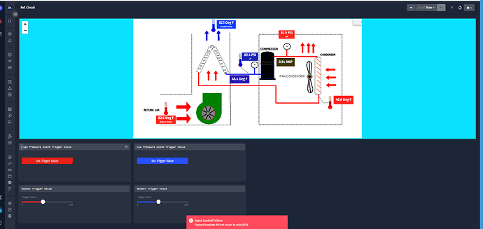

I’ve implemented with the same workflow other Dashboard using Image Overlay.
The function are the same that those implemented for the dashboard called Data Display.
The point is that when I’m adding set block and slider like those at the first dashboard and click on the set button, a red pop up comes up telling " Payload template did not render to valid JSON.
The setting for the set button and slider are the same that those running OK in the first dashboard
Thank you very much in advance.
Hi @Tron7,
You are getting this error as your {{range-0}} and {{range-1}} values are empty strings since the buttons don’t have access to these variables. You will only be able to access these variables if they are configured together in one Input Control Block.
Since all of these are in four separate blocks, they do not have access to each other’s values. I would recommend putting them in two separate blocks instead of four, so that the “Set Trigger Value” buttons have access to their respective sliders.
