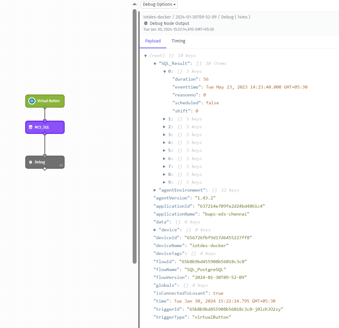

I have an issue here. Need to ingest the array of data captured from SQL server into postgreSQL for my project. which is the easiest to ingest array of data into postgreSQL. Please find the below image how my payload looks like.
This is the workflow I developed to ingest one row of data into PostgreSQL. And it is working as expected.
Thanks in advance!!!

I am capturing few datetime stamp from SQL server. In the same time format, I need to ingest the data into postgreSQL. What I have issue here is when getting timestamp to Losant workflow it is automatically taking the timezone of my geographical location. I was trying with date/time node to match with original time format, but it is not working. Attached here the sample Image FYR. The actual time should 2023-05-23 02:23:40 but instead I get Tue May 23, 2023 14:23:40:000
can I get any comments?
This indicates that the value on the payload is parsed into a JavaScript Date Object, which is being localized and represented in your time zone by your web browser; for example, the same payload for me appears in the debug log as Tue May 23, 2023 04:53:40.000 GMT-04:00
