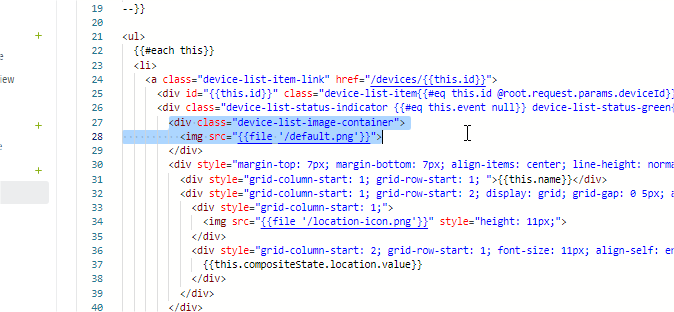

first I want to change the default image in the device list to a custom image for each device and add it from the file list.
Currently, all devices place the default image in the device list
device-list-image-container-be. I want to solve this where an image is assigned to the device instead of the default image.

Yes, it’s a very simple change.
  1. Add a tag to your devices - let’s call it “imagePath” - and set its value to the location of that device’s image in your application files. For example, to use the image that’s included in the template, you would set the value of that tag to “/asset-tracker.jpg”.
  2. In this file you found, on line 28 (what you highlighted), change the src attribute to “{{file this.tags.imagePath}}”.
  3. Save the file.
You’re just referencing a value on the device - the tag you added in the previous step - the same way you reference any other value on the device object, using that variable instead of the static value in the {{file}} helper.

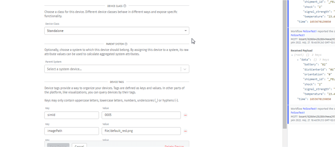

yes i created the device tag and put the image file in the Files.

Your “imagePath” value isn’t following the format from my example; you have in there “file/default_red.png”. It should begin with a slash (/) and, assuming that file is located in the root directory (which I can’t tell from your screenshot), it should be “/default_red.png”.
the HTML source doesn’t seem to open the image, I think I may have corrupted the file path.
Gmail, Hologram
all you need here is: /default_red.png
and it works.

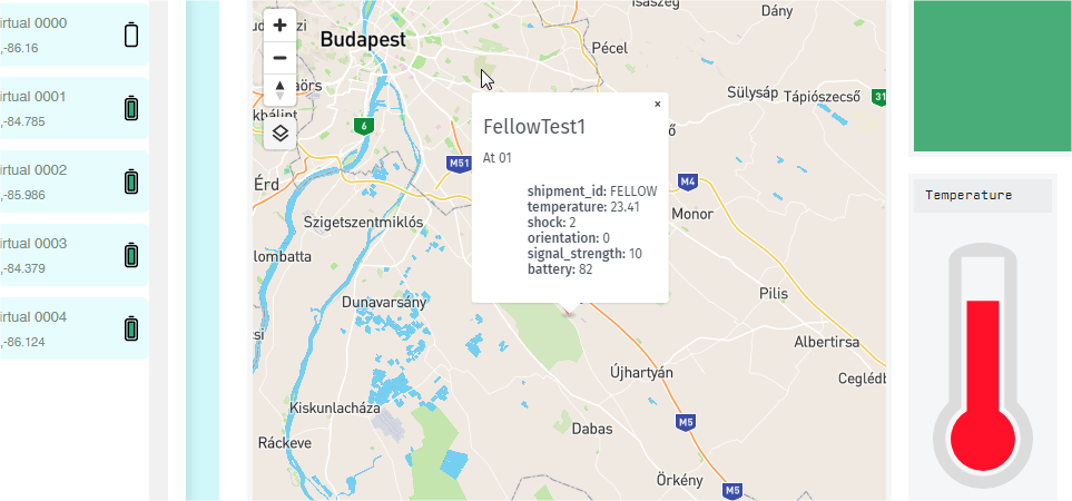

I would like to display this image in the pop-up text box by clicking on the map.
can you help me with that too?
The popup supports Markdown; using the available variables and the Markdown syntax for rendering an image, you should be able to get the image to render inside of there along with the other variable values.

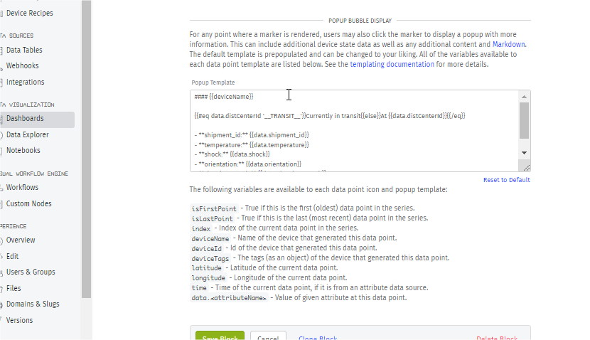

do I refer to the device label again?
Can I configure it in the control panel pop-up template?
could you write an example code for this too?

It seems the {{file}} helper only works in Experience Views; I’m going to file a ticket about getting that resolved.
In your case, you can get the image to display by writing out the front portion of the URL manually and referencing the tag within it:
![Image Alt Tag](https://files.onlosant.com/626962745d1e901caeb5f9c0{{deviceTags.imagePath}})
where 626962745d1e901caeb5f9c0 is the ID of the application where the file is stored.
yes super, it already works. I still need to add the scaling to display it in the specified size. :slight_smile:
