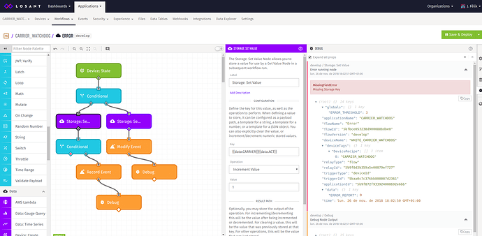

Wouldn’t be possible to store a value with a key took from the payload? Have a look at the screenshot below. If I could just store a value setting the its key from the payload (as in {{data.CARRIER}}{{data.ACT}}), I guess the effort will be reduced. But I believe Losant does not support storing values defining the key from payload (have a look at the “MissingFieldError Missing Storage Key” error in the debug node).
Is there any other way of allowing Losant generate and store values with random keys from the payload?

So I can see on your payload that both data.CARRIER
and data.ACT
is not on your payload, you need to send those in the device state object. That is why you are getting the Missing Field Error
. Once those are on your payload then you are right {{data.CARRIER}}{{data.ACT}}
will create the proper key, since it can be a
string template.

You are trying to use a string template in a result path, where the Result Path
field can only be a string e.g. ‘data.currentStoredValue’. This is actually a validation issue and I’ll file a ticket to have that updated since that is not a valid path.
At this point in your workflow, you have already incremented the key {{data.CARRIER}}{{data.ACT}}
, you don’t need to use that as the payload path you store the result because each time this workflow runs it’s only going to increment or clear one device state object. And then don’t forget to update your conditional below to use the string path.
