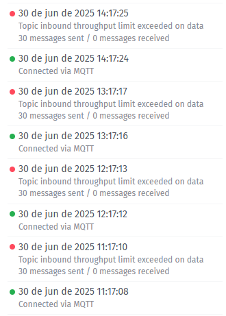

Hello,
I’m using a Weintek HMI to publish data via MQTT. I’m using this device because it offers more flexibility in its programming.
It has a buffer storage that retains messages in case of an internet disconnection.
The problem I’m facing is that I have no control over the time interval between messages when the device reconnects to the broker. Upon reconnection, it sends 30 MQTT messages in less than a minute, which results in a 1-hour disconnection from the broker.
The issue is that during this 1-hour disconnection, another 30 messages are stored, creating an infinite loop that never returns to normal operation.
Is there any way to force the broker to maintain the connection with the device, or is there another solution to this problem?
