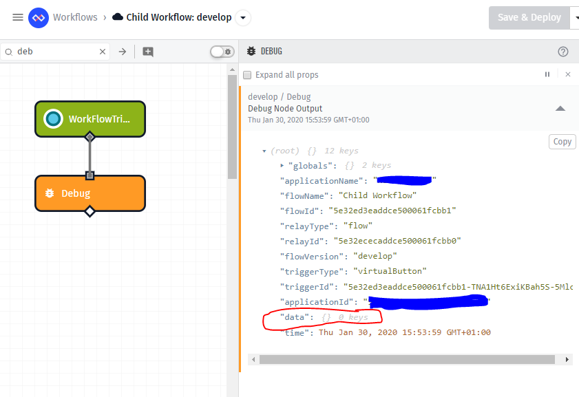

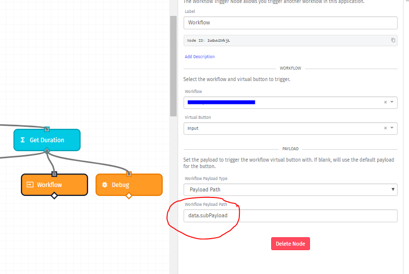

I tried a few time to use data.subPayload to transfer all data fields of a current workflow to a Triggering one. I do it as the following:
For some Reason, I am never getting my embeded payload inside of a triggering workflow.
Could you help me to find an explanation why it does not work?

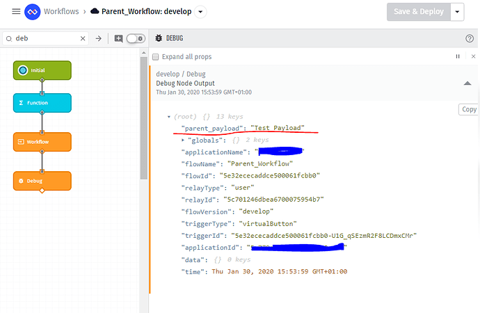

My Parent Workflow
My Child Workflow
Hi @Alexander_Kondrov,
If data currently exists at data.subpayload, you should be seeing at least a single value beneath data. I was able to locate a possible issue and am exploring it further; to assist in my testing, I am going to send you a direct message with a couple of data and export requests. I will respond to this thread when I reach a solution.
